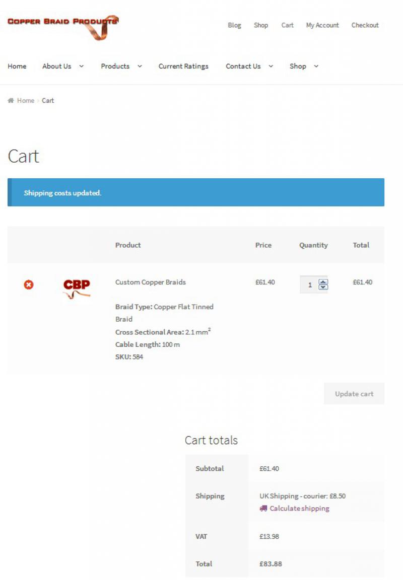

Commander
Custom Copper Braids × 1
item_details: Braid Type: Copper Flat Tinned Braid
Cross Sectional Area: 2.1 mm2
Cable Length: 100 m
SKU: 584
D'un montant de €94,81 EUR
Vers un montant de £81,42 GBP
Taux de change : 1 EUR = 0,858792 GBP
PostPosted: Mon 9 Oct - 21:26 (2017) Reply with quote
Pas cher Shocked
Le dernier rouleau que j'ai acheté 126.82€ les 100m port compris Rolling Eyes
